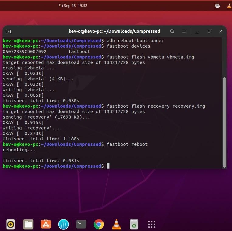

[attachment=8241][attachment=8241][attachment=8242][attachment=8241][attachment=8241]Hello
i flashed the ported TWRP.img to my tecno camon 12 air c66 through adb fast boot that is after flashing vbmeta.img.  the device cant boot its now on boot loop cant go past the tecno logo or boot to recovery.i was using linux ubuntu then but hav now completely moved to windows.  what can i do now to restore my phone..its driving me crazy..hav Attached the terminal output of the commands used and device info...PLEASE HELP.

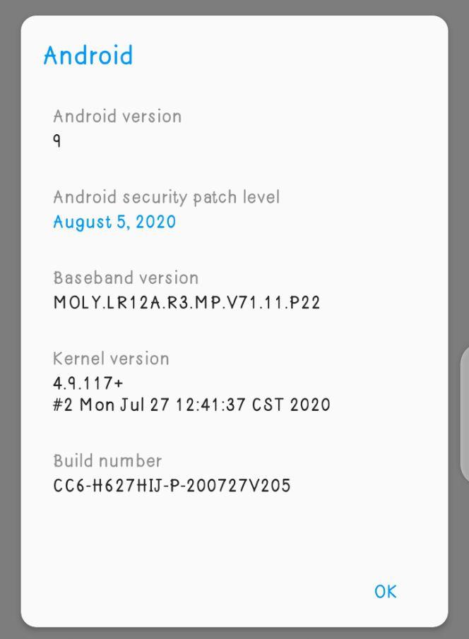

hav flashed this stock rom Tecno Camon 12 Air CC6 (CC6-H627HIJ-P-191023V160) [Factory / Signed]  @https://forum.hovatek.com/thread-30464.html successfully. but still need TWRP recovery for this device

good! you figured how to brick
did you flash empty vbmeta or the stock vbmeta? i.e before flashing the twrp
if empty vbmeta, did you confirm that the device could still boot to homescreen after flashing empty vbmeta?
where did you get the stock recovery you used for porting twrp from? for the same build number as your phone?
RE: camon cc6 on boot loop after flashing TWRP recovery - kev-o254 - 22-09-2020
I Flashed the vbmeta.img provided together with twrp recovery.img in the zip from here https://techzbyte.net/2020/08/twrp-for-tecno-camon-12-air-cc6.html .The guy said it would work for my device build claim to have been ported for camon cc6 by hovatec

check the build number within the twrp.img using the method 7 @ https://forum.hovatek.com/thread-16005.html
see if it matches with the current build number on your phone i.e CC6-H627HIJ-P-191023V160
if it doesn't then best you try porting twrp using your stock recovery and the tool @ https://forum.hovatek.com/thread-21839.html

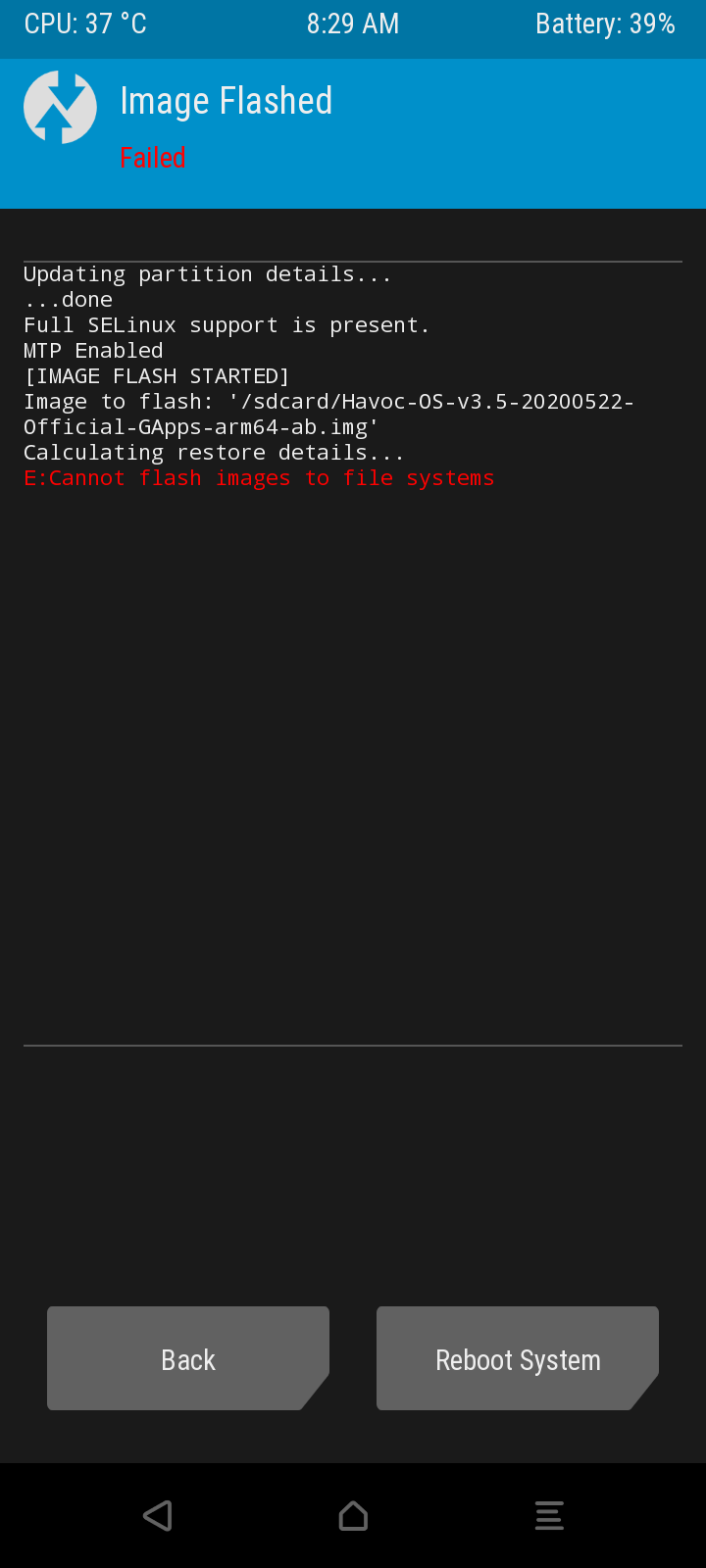

I hav ported twrp for my device using the stock recovery.img and the auto twrp porter then flashed empty vbmeta.img and the ported twrp recovery.img using sp flash tool
The recovery was flashed successfully but when i boot to twrp it cant mount storage or decrypt then when i boot to system and reboot back to recovery it goes back to stock again..and every time hav to flash twrp recovery again

(24-09-2020, 02:28 AM)kev-o254 Wrote:  ...
see https://forum.hovatek.com/thread-30160.html
(24-09-2020, 02:28 AM)kev-o254 Wrote:  ...then when i boot to system and reboot back to recovery it goes back to stock again..and every time hav to flash twrp recovery again
see https://forum.hovatek.com/thread-10992.html ; the section that talks about renaming recovery-from-boot.p
