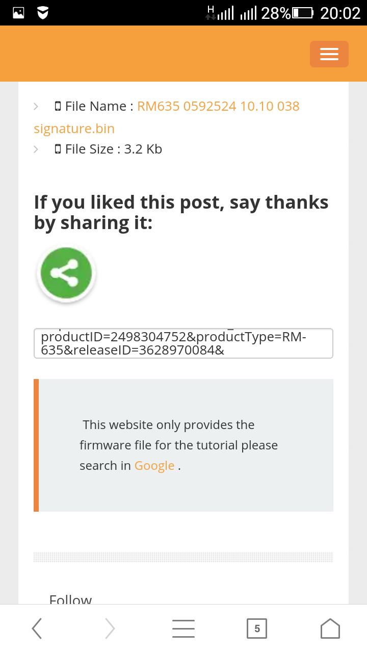

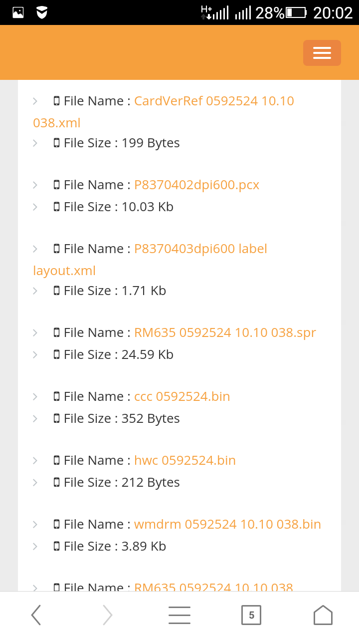

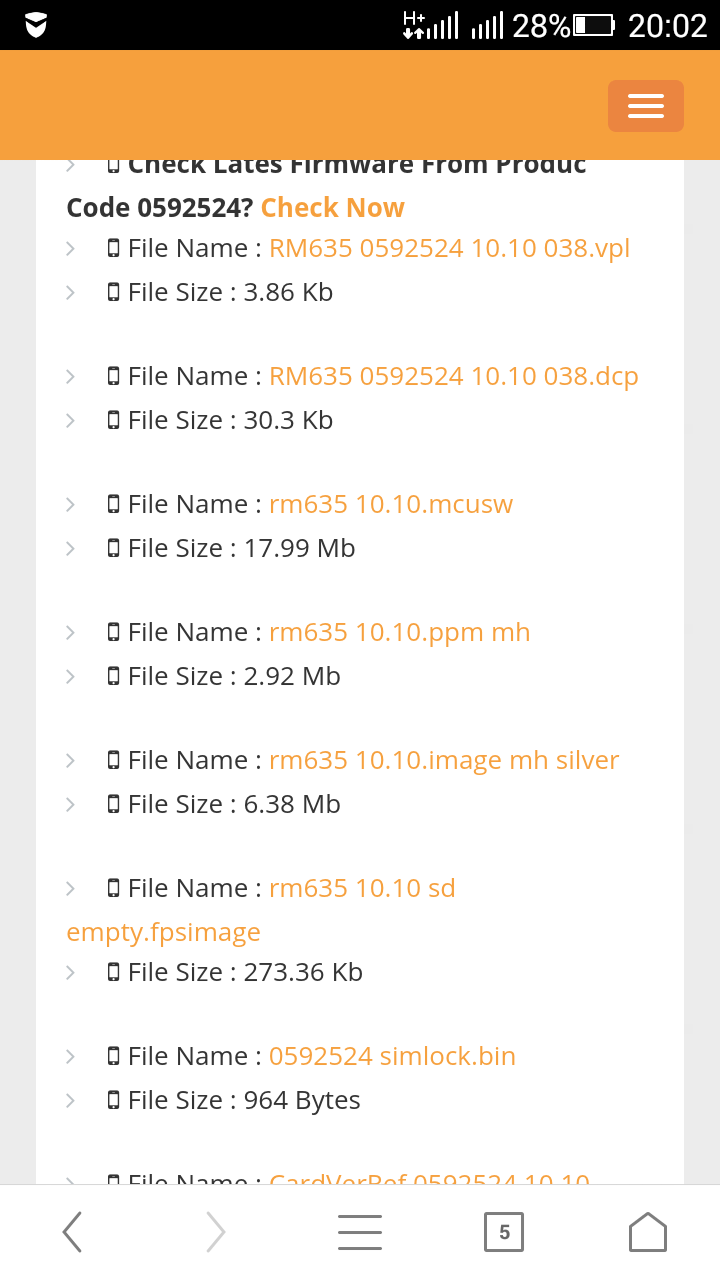

Hey Guys, I'm Having Nokia 2690, Its Dead, I Want To Flash My Mobile With Phoenix Service S/W,
Mobile:- Nokia 2690
Product Code:- 0592524
I've Downloaded Firmware Of My Mobile From Following Site..
http://mrcrab.net/nokia/Nokia_2690.html?...sion=10.10
I've Done All Things, But I'm Getting This Error:-
“Currently Selected Data – Package Retrieving Failed: 0x840E0818 (-2079455208) – Framework:
The Digital Signature Verification Failed Because The Signature File Could Not Be Found”
How To Solve This Problem?? Give Any Solution ASAP... Thanks...

thats not the screenshot i need.. i needed the list of files you've already downloaded
* see this guide @ https://www.hovatek.com/forum/thread-3464.html (use the picture in step 6 as reference)
* rename the files you downloaded (remove every letter till after the first underscore _ sign)
* then try flashing again
