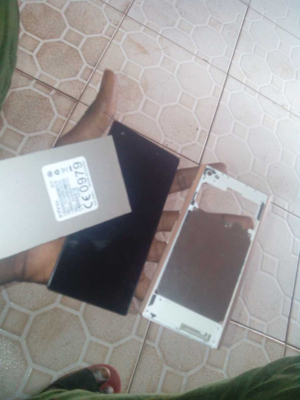

You hav 2 options bro.
1. U let d phne be at one point d b3 wud run down and it'l charge
2. Unscrew d phone and take out d b3 nd plug in d charger b4 u socket d b3 bk 2gda.
I personally, b4 i sp a zero i make sure d b3's low so it wudnt take much tym 2 get bk on.
Hope i help.
#PEace
there is no screw on infinix zero. is there any other method. cause my phone can't charge
Hope i help.
#PEace
I'm telling you. I have worked on the Zero xo many tyms. If u use a sharp knive n take out dat back glass u'l see m screws
.jpg   uploadfromtaptalk1421852535476.jpg (Size: 59.35 KB / Downloads: 2)
