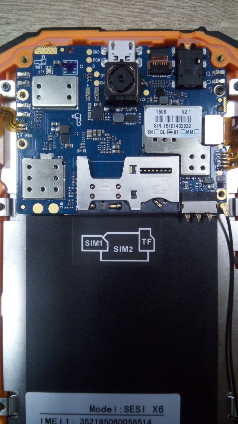

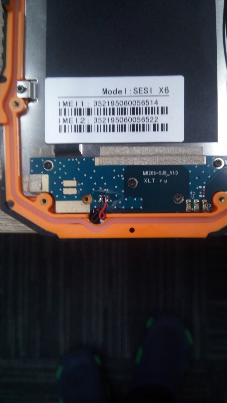

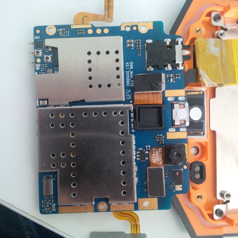

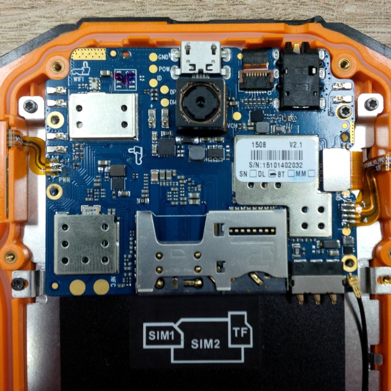

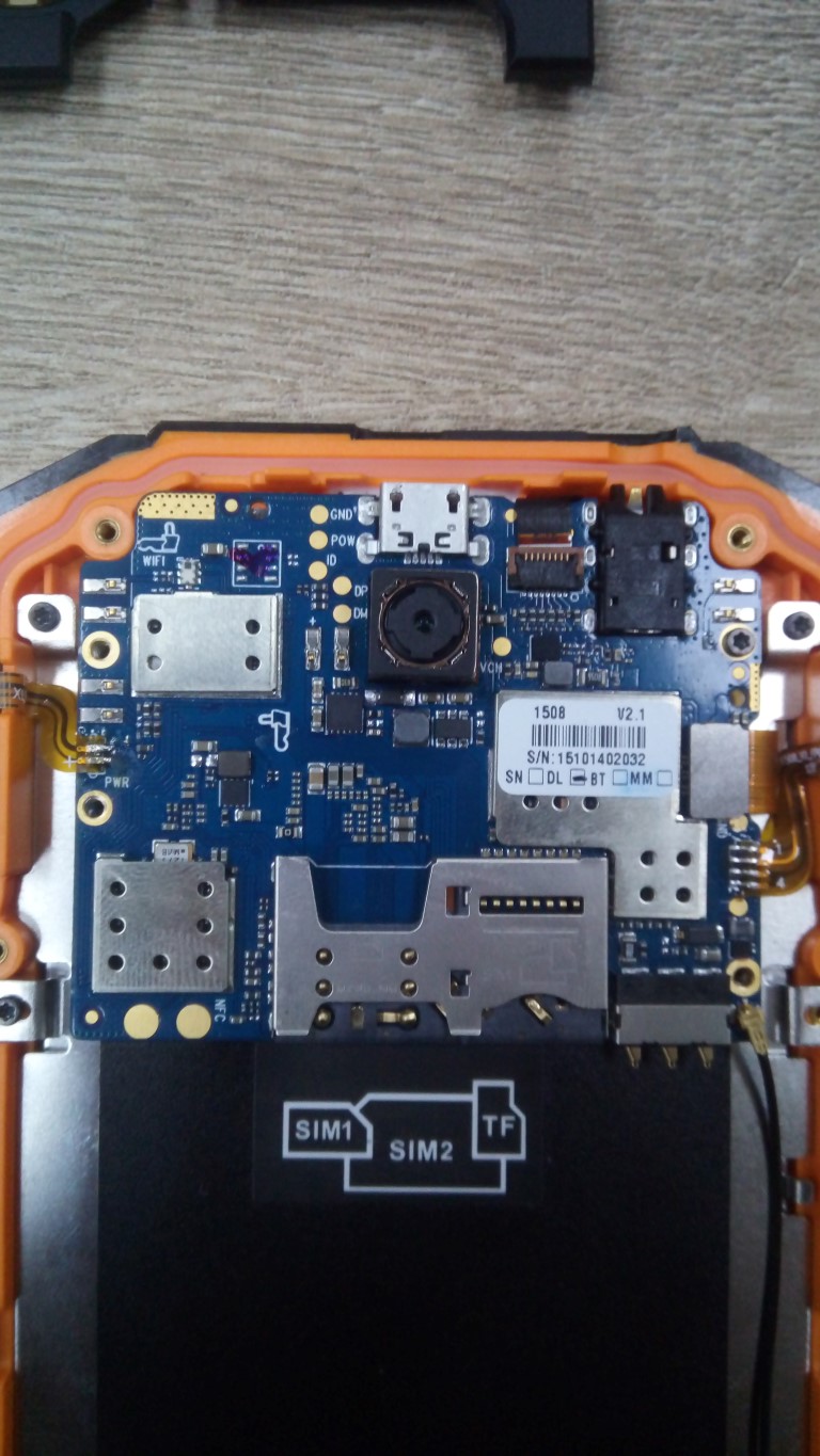

I have a MTK (MT6735) device (HUADOO HG06) which is bricked and not detected by PC. It happened after flashing wrong ROM. I'm trying to do board jumper method, but can not find KCOLO or TP golden points.
Pictures are attached.
Anybody has an idea what to do?

I realized there are DM and DP they are just like Tx and Rx for COM port operation on USB operation
Sent from my INFINIX-X551 using Tapatalk
Short USB D+ to DM and USB D- to DM then GND to gnd on Phone PCB, then insert USB cable to PC, you may need a DC power supply to power the board +ve and -ve for correct detection

Bro, you really have to take the PCB completely and check whole board, certainly there is a test point on the board

I have disassambled all the board and checked the other side facing down as well, maybe one of the unnamed points is TP? Can I find a description of this PCB from somewhere?
BTW, can I use PC USB output as a DC supply, or should I use, wall plug to USB as a DC power supply?
One more question, what is USB D+ and USB D- ? I assume they are not on the board?
Thanks for reply.

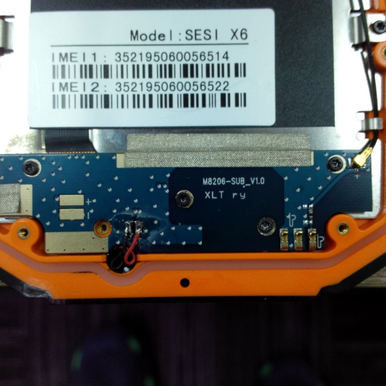

Here is the back side of the board as picture.

If you are not finding the test point, you may have to manually try all other unnamed points with gnd and connect
But that's very tedious to do.....

D+ is DP on phone PCB and D- is DM , is found on your PCB
