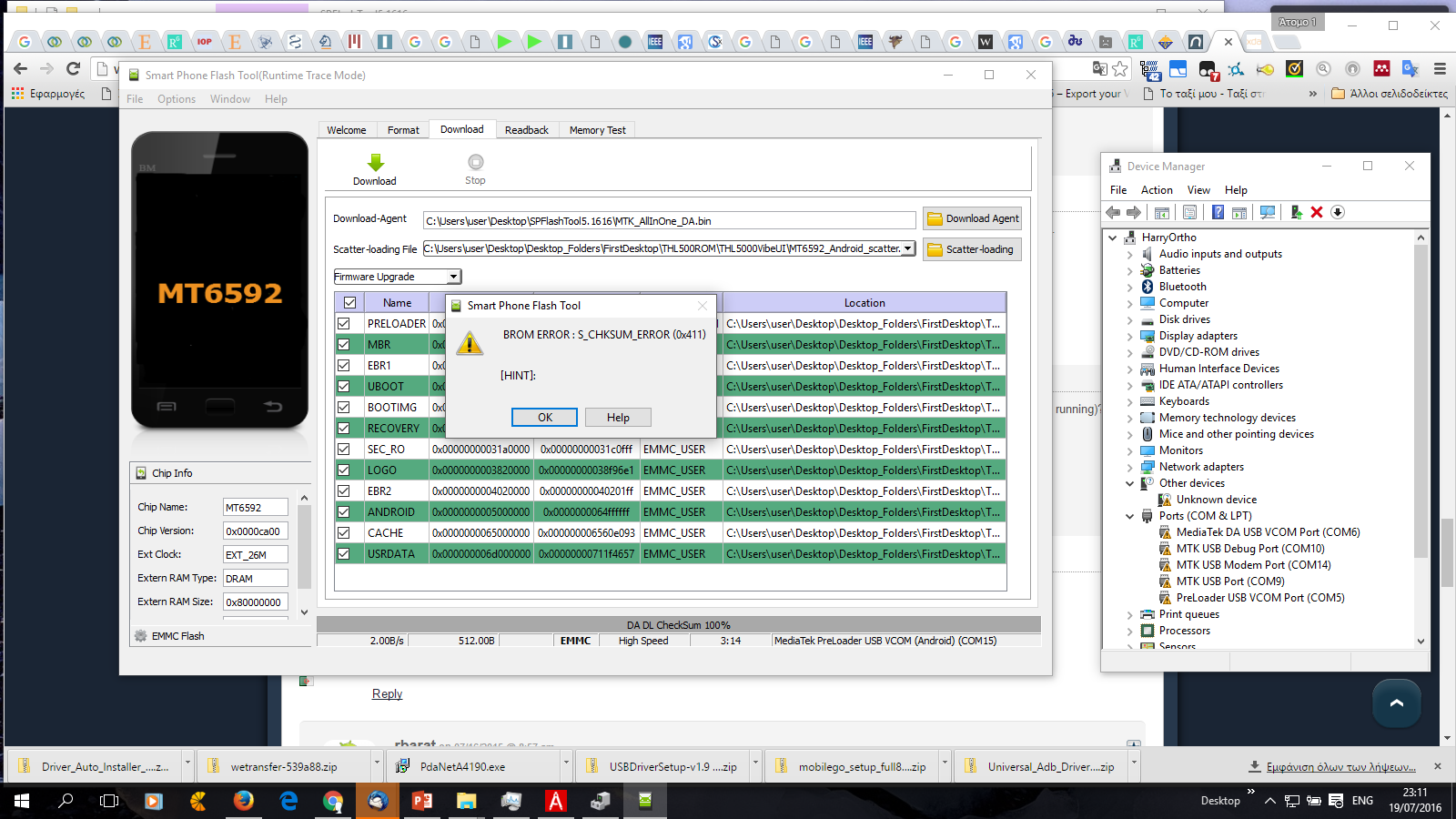

I flash a rom for my THL 5000, I get it from NeedROM the VibeUI_1.5GB.
I load the scatter file from this folder, at the end of the firmware upgrade/ flash I get BROM ERROR S_CHKSUM_ERROR (0x411) I am not sure what this means and there are no links on it.
I have tried this with a previous ROM I scattered on my phone which did not work. So I don't believe the ROM is the issue.
I am wondering if it is the drivers on the laptop- if so then I don't know how to solve it as I have already installed them and changed them to others and the VCOM still works. So not sure.
When the DL and DA Check are unchecked in the options the software displays a green tick and says it was successful but the phone does not boot up.
Any idea what is happening
Also you will need to add this to the BROM ERROR Smart phone flash tool thread you have once you find a solution.
Harry
.png   BROM_Error.png (Size: 250.54 KB / Downloads: 23)
I have sent an email to the hovertek support with the log files of the flash process, for some reason when I tried to attach them the were not permitted to be uploaded. If you do a search in the .log file, type in chksum_error and you will see a few instances of problems.
How else can I provide information to help?

Check your firmware folder and delete any checksum.ini file also make battery in the phone is charged

you need to untick da dl all with checksum then flash.
now, after flashing, is the phone totally dead or gets stuck at logo?
Phone charged overnight
I previously tried to flash the old rom, I pressed the reset button, this then loaded the old rom but this often is met with acore process has unfortunately stopped. So that is not an option.
Also flashing with the boxes checked makes the error.
I pressed the button for reset, while the blue thl logo was on as I tried to do a download to that. As on the phone it is hard to know if the phone is on or off. On and off button did not work show much effect. I pressed the download while the phone was connected while the logo thl in blue letters against a black screen was displayed.
I am not sure if download/format +download or firmware upgrade is best, we will see.
I have done both since the errors.
I will try the same without the boxes ticked, I don't think it made a difference.
Also could not find a chksum.ini file in the scatter loading directory so I don't know why that would be an issue.
