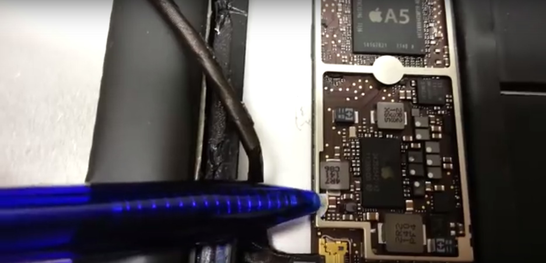

I think the Backlight chip is not pressed down firmly enough. Check my attachment below maybe it can help point you right
Sent from my Infinix X510 using Hovatek Forum
.jpg   ScreenHunter_185 Jun. 19 10.03.jpg (Size: 159.12 KB / Downloads: 14)

Here
[Image: iPad-2-backligvht-chip-min.jpg]
