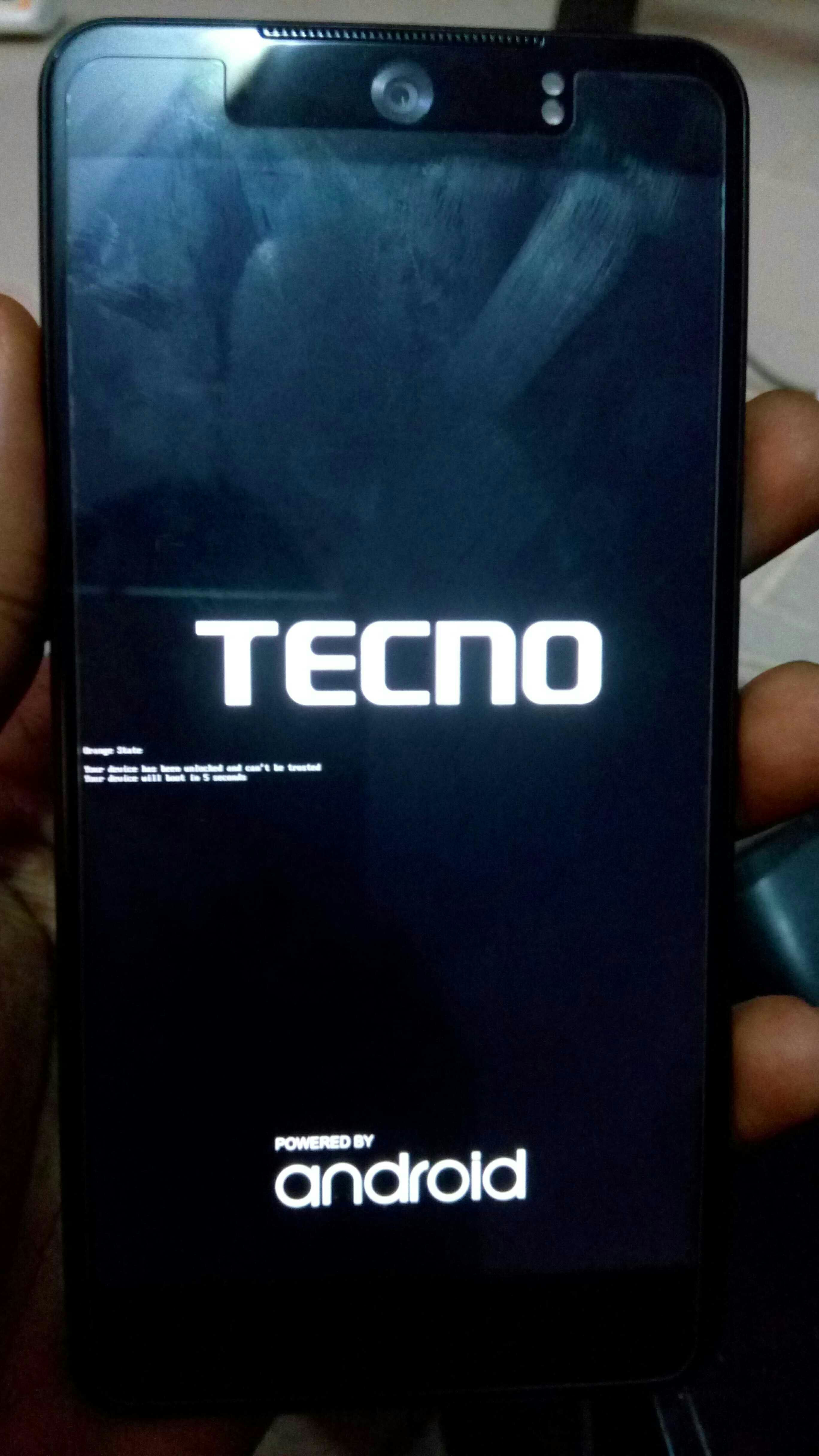

[Development] How to root the Tecno Camon CX
(This post was last modified: 12-23-2017, 02:07 PM by X3non. )
[Image: Hovatek-How-to-root-Tecno-Camon-CX.jpg]
The Tecno Camon CX (e.g CX-H501D1-N-170405V107) is an MT6755 / MT6750 powered phone running on Android 7 (Nougat)
How can I root my Tecno Camon CX?
There are two main steps:
  • Unlocking the Bootloader of the Tecno Camon CX
  • Flashing the Hovatek TWRP / Philz recovery.img and SuperSU.zip
Procedure
  • Download either custom recovery below:
  • TWRP for Tecno Camon CX-H501D1-N-170405V107 [MT6755] ported by Team Hovatek @ [ Please, Login to view this link]
  • Philz for Tecno Camon CX-H501D1-N-170405V107 [MT6755] ported by Team Hovatek @ [ Please, Login to view this link]
  • Philz for Tecno Camon CX-H501DEFG-N-171109V159 [MT6750] ported by Team Hovatek @ [ Please, Login to view this link]
  • Setup ADB and Fastboot on the PC using the guide at https://forum.hovatek.com/thread-588.html
  • Extract and copy the TWRP / Philz recovery.img into the same folder as the fastboot.exe and adb.exe
  • Unlock the Bootloader of the Tecno Camon CX using the guide at https://forum.hovatek.com/thread-18936.html
  • Download SuperSU 2.76.zip at [ Please, Login to view this link]
  • Copy SuperSU.zip to both the phone’s SD card
  • Connect the phone to the PC via USB cord while switched On and boot it into Fastboot (as instructed in the Bootloader unlock guide; don't forget to re-enable OEM unlocking and USB Debugging)
  • When the phone enters Fastboot, load the TWRP / Philz recovery to the phone by typing the command below then pressing Enter
fastboot boot recovery.img
  • The phone should automatically boot into TWRP / Philz recovery mode (depending on which you flashed)
  • Do a full backup by tapping Backup (Recommended) then proceed with the guide once done
  • In TWRP, if you get a prompt asking you to swipe to allow modification of the System partition, tap KEEP READ ONLY
  • If TWRP / Philz offers to root the phone, select NO
  • In TWRP / Philz recovery, tap Install
  • Navigate to the location of the SuperSU.zip on External SD card and select it
  • Swipe to confirm flashing of SuperSU.zip (if prompted) and wait till flashing is complete
  • Reboot the phone normally
  • Confirm Root by installing and running Root Checker
