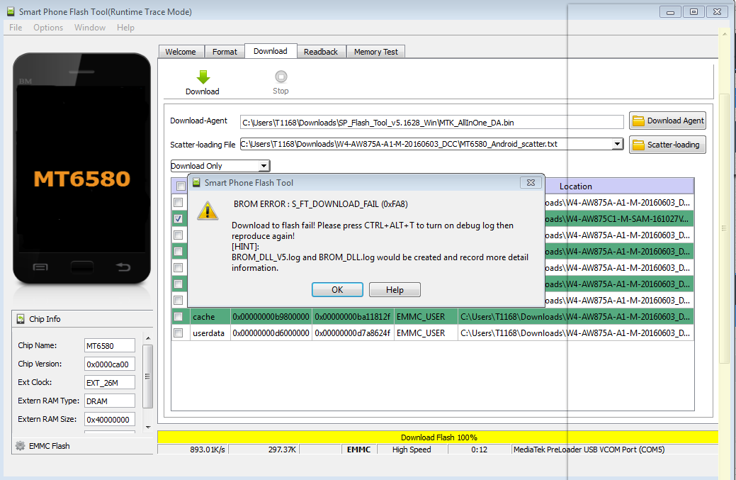

I HAVE DONE THAT AND THIS IS THE ERROR I RECEIVED .
.png   Capture.PNG (Size: 77.46 KB / Downloads: 7)

(07-21-2017, 07:29 AM)Ayodeleowoetoni Wrote: I HAVE DONE THAT AND THIS IS THE ERROR I RECEIVED .
You'd previously flashed these ROMs im asking you to flash so this error shouldn't be something to worry about.
Lets reshuffle the procedure
Flash W4-AW875C1-M-SAM-161027V13_DCC first then flash only preloader.bin from one of the the ROMs that gave you multicolored screen. Note that to flash only preloader, you simply untick all but preloader
Can SP flash tool also do that ? i mean can it work without giving that error .... and when i want to flash the preloader.bin am i to use the scattered file of that coloured screen rom? Thanks
I have tried it Just nw. i got a pop up saying PMT changed for ROM
