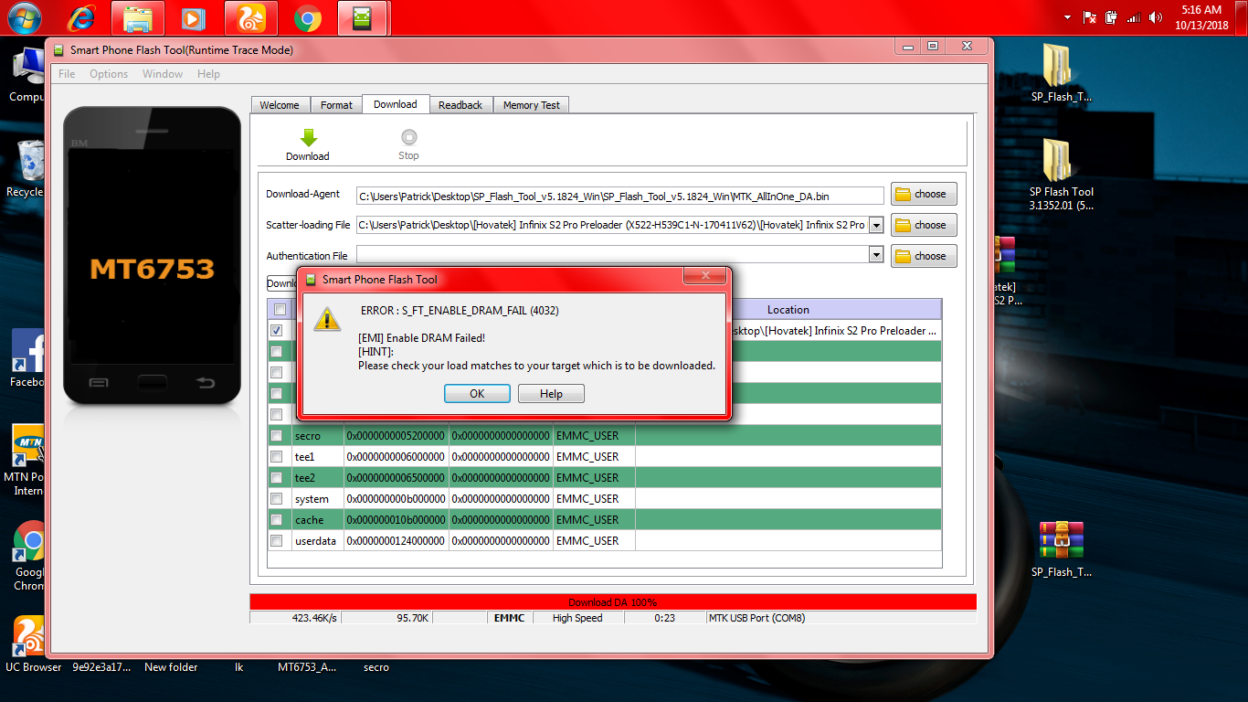

My infinix x522 got bricked in the process of installing twrp recovery via sp flash, its totally dead, its not powering on but it indicate on my pc when connected, i have tried flashing a new firmware with sp flash, but its gives me an [ENABLE DRAM FAIL error] when about to proceed, i also tried flashing with miracle box, but unfortunately i received a [BOOT DATA FAIL ERROR]. I dont even know what to do now..... Huh , am felling very much sad....  Sad  with this issue. more than a week now since my phone got bricked. please can someone help me out of this problem, i would be very much happy if someone help me out of this

If all you flashed was recovery.img using downlaod only then there shouldn't be any need to flash a full firmware as @x3non and @emmanus have said, simply refer to https://www.hovatek.com/forum/thread-808.html ...unless you're not telling the whole story.
What option did you select when flashing the recovery. You need to tell us more so we can help.
Concerning the sp flash tool & miracle box errors, lets see full screenshots of both. Also where did you get the firmware you're trying to flash and what's the build number
