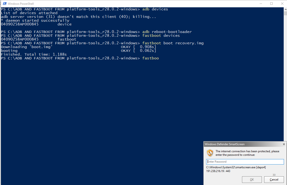

when i tried this command "fastboot boot recovery.img", it downloaded boot.img in instead of recovery.img.. is this okay
also is there a command like "fastboot boot boot.img", and can it be used to download a patched boot.img file?

(13-06-2019, 11:24 AM)dapo4friends when i tried this command "fastboot boot recovery.img", it downloaded boot.img in instead of recovery.img.. is this okay
the command "fastboot boot ***.img" attempts to boot whatever ***.img is (whether boot or recovery.img) so be sure that *** in your case is the ported twrp image.
if you attempt to boot a recovery.img (stock or custom) then the device powers to recovery mode, and if you attempt to boot a boot.img (stock or patched) the device powers to homescreen
using it along with a patched_boot.img file should boot your device with magisk temp. installed until you perform a regular reboot
