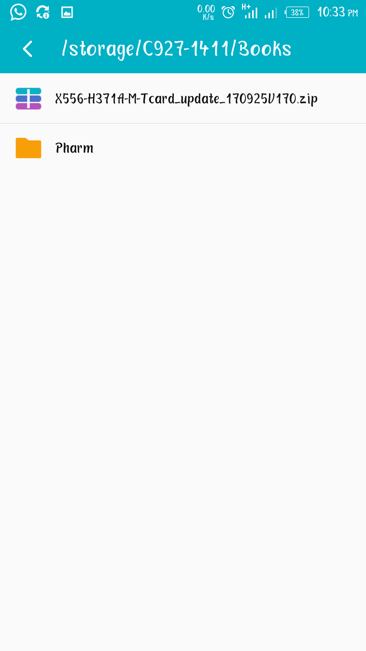

hello please i want to upgrade my infinix hot 4 pro to X556-H371A-M-170925V170 build number . but the OTA update is not working. I have successfully downloaded the tcard update file of this build number (X556-H371A-M-170925V170) . PLEASE HOW DO I RUN IT ON MY PHONE USING SPFLASHTOOL. I want to update it to this build number - X556-H371A-M-170925V170 which is the current update i am receiving via OTA but it is not working. My current build number is - X556-H371A1-M-170330V150. Please help me out. i would appreciate a response with a detailed step on how to go about this. I want to upgrade my marshmallow the latest marshmallow before moving to nougat , but it seems OTA updates dont work for me anymore, please id like  a detailed step on how to do this using spflashtool.......... Thanks in anticipation

you cant flash OTA update.zip using spft
either you copy the update.zip to sdcard then reboot to recovery mode (vol up + power button) then select apply update from sd

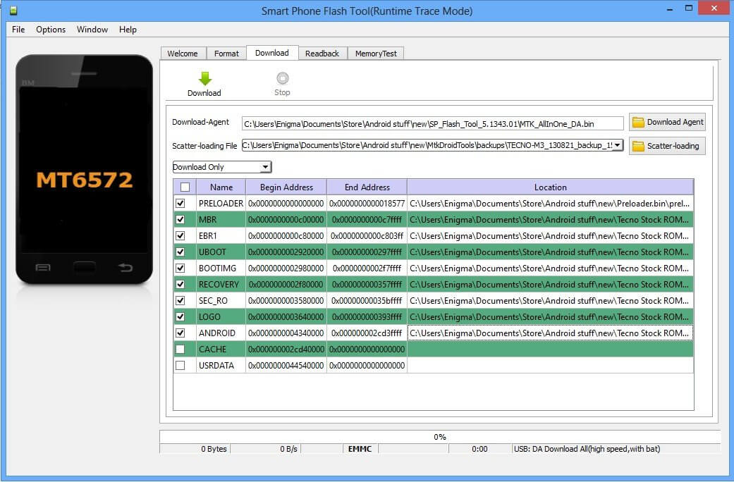

PLEASE SHOULD ALL THIS FILES BE TICKED WHEN FLASHING THE REQUIRED FIRMWARE ??

(20-08-2019, 05:35 PM)Fortunef3609 PLEASE SHOULD ALL THIS FILES BE TICKED WHEN FLASHING THE REQUIRED FIRMWARE ??
all files within the firmware you download will be ticked upon loading the firmware and should remain ticked
