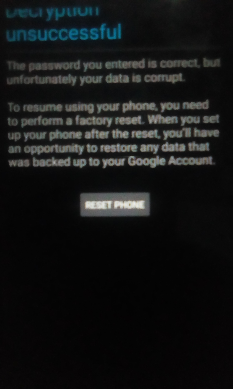

Hi, I got this Tecno Camon 11 that requests a "password" (No one set it) inorder to power up fully. I've input random characters are input as the "password" surprisingly it accepts but with a prompt about "corrupt data... hence a factory reset will be perfomed". Upon reset, it reboots to the same!
Any work around for this apart from a full flash of the firmware (format inclusive.) - got limited data Exclamation

(27-01-2020, 05:46 PM)Wormlilo Hi, I got this Tecno Camon 11 that requests a "password" (No one set it) inorder to power up fully. I've input random characters are input as the "password" surprisingly it accepts but with a prompt about "corrupt data... hence a factory reset will be perfomed". Upon reset, it reboots to the same!
Try this https://www.hovatek.com/forum/thread-23839.html

I had a try on it. No success. Still on the loop.

(27-01-2020, 11:37 PM)Wormlilo I had a try on it. No success. Still on the loop.
then the last option is flashing the stock ROM.
Download the stock ROM @ https://www.hovatek.com/forum/thread-311.html
Download DA for your phone @ https://www.hovatek.com/forum/thread-23243.html
Follow the guide @ https://www.hovatek.com/forum/thread-159.html to flash your phone.
