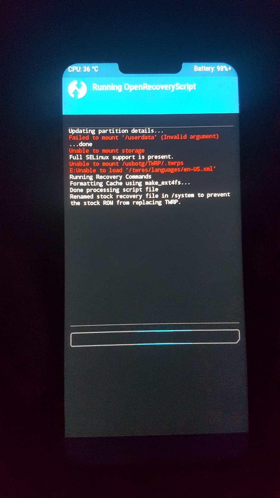

So I recently bought this no name phone and obviously I wanted to root it. And well I obviously bricked it. I tried flashing some recovery I found online that looked compatible with the phone. Didn't backup anything cuz I thought it would be harmless. But yeah. The phone doesn't even boot anymore. Not to the system nor to the recovery. I can get it to fastboot though. I'm pretty sure the recovery is the only problem here. All other system files were left untouched. I only have this old log file from MTK Droid Tool. For some reason it registered two different devices. But yeah mine is the Mate 39. I attached it on the thread. Can anyone help me on my quest to unbrick the worthless thing? I'd be eternally grateful
Here's the recovery I used to brick the phone:
https://drive.google.com/open?id=1kK46Ff...5Ahmdw-tYS
Here are the most important info that you can also see in the log file:
Build Number: l700_lyx_k3_welcome_q_540x1200_128a16_en_yl_v11
Processor: MT6580
Andorid ver.: 10.0 (I have a really hard time believing that but that's what the phone and the log say)
Model: Mate 39
Kernel: 3.10.72

Okay wow. I haven't unbricked it yet but I see progress here. I've worked a lot on it and through your idea I got the phone to go from a normal bootloop to a twrp bootloop. So yeah. I finally installed the right twrp it seems. But now it just keeps bootlooping the TWRP-Logo. Turns out the OS is based off of android lollipop. What a ripoff. Any idea how I can get TWRP to work at least? I still can't boot into the phone yet. I used version 1.4 and picked lollipop like I said. I also tried using the philz recovery porter v1.5 in which case I got an endless boot logo. I also tried using fastboot to wipe the userdata partition but the phone doesn't recognize the command. Any ideas? Trash can?

Really close. I tried versions 1.2 and 1.0. Both work.Also tried Spreadtrum which worked the best and I can boot into twrp with it. But well...I think I need to format the data partition somehow to finally boot into the system but twrp can't mount any partitions. Not even cache. It can't even see that they're present so no repairing either. And like I said I can't format it using fastboot. I can only boot into twrp and system is still on bootloop. Any way out of this?

Well just one problem. The boot.bin I renamed to recovery.img IS my stock recovery. And boot.bin doesn't even have the etc folder. I renamed the recovery.fstab from the ported TWRP to recovery.txt and attached it to this reply if you wanna take a look. And btw thank you so much for taking the time and helping. It's very kind of you. Lemme know if you have any ideas on how to proceed.

Yeah I replaced all the mount points and all the directories with the correct ones and now I have an unable to find crypto footer error. I can't get into the recovery anymore. It can't mount the data partition. And it just keeps rebooting into twrp, twrp runs the openrecoveryscript, fails because it can't mount the data, reboots again and again. I'm pretty sure if I could format the data partition I could break the encryption and get in but the fastboot command doesn't work. I tried unpacking the system.bin that I made a backup of but I can't. Not sure if it's corrupted or if AIK just doesn't work with it. Any ideas?
