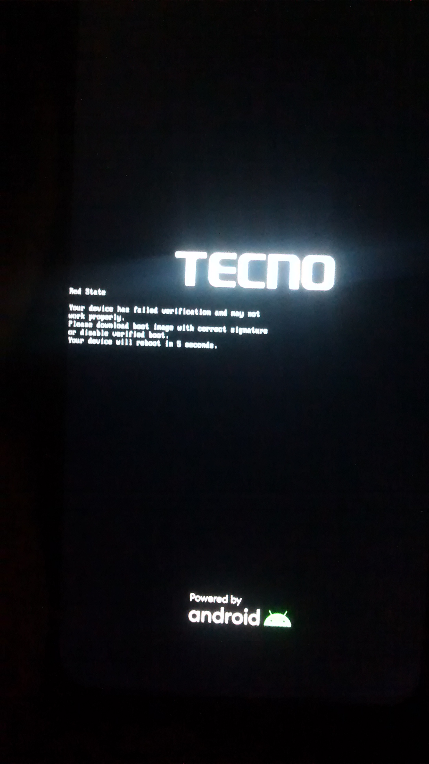

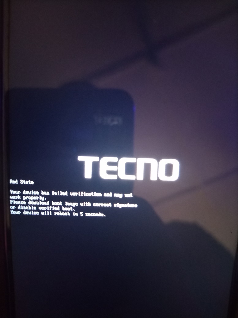

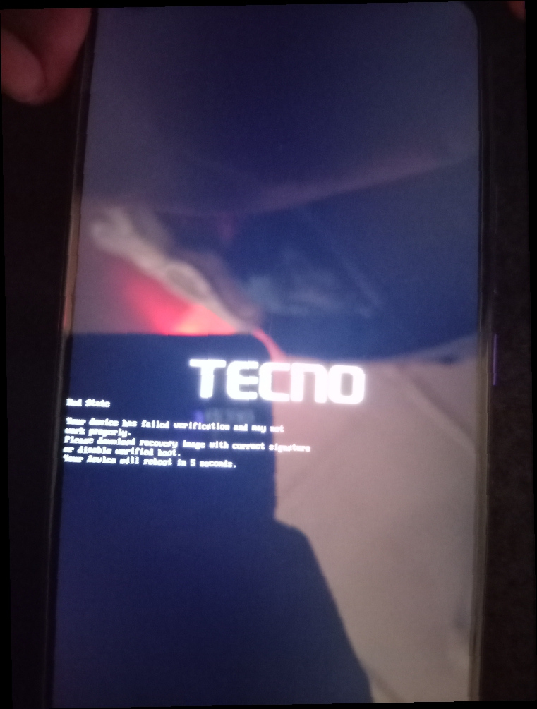

you didn't answer any of my questions
you flashed all files within the *-GL-* firmware successfully and factory reset in recovery mode? and the device still remains in red state bootloop?
