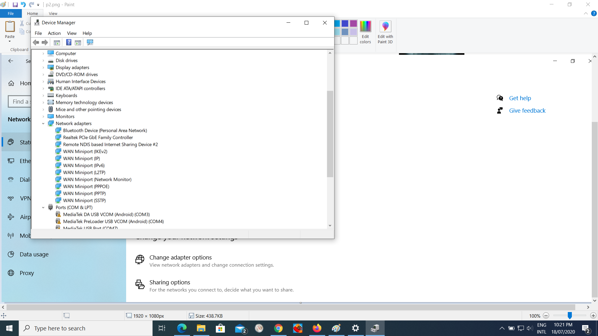

Hi hovatek please i need your assistance on my windows 10 pro i receive notification to download and install windows update but after i have done with the update and installation i noticed that i can't turn on wireless on my pc in fact the wireless adapter has totally disappeared from my pc, i check even in the task manager, network setting and notification bar so i hope you have the solution on how i can fix this problemĀ
18-07-2020, 11:34 PM
(18-07-2020, 10:35 PM)mustysmart Hi hovatek please i need your assistance on my windows 10 pro i receive notification to download and install windows update but after i have done with the update and installation i noticed that i can't turn on wireless on my pc in fact the wireless adapter has totally disappeared from my pc, i check even in the task manager, network setting and notification bar so i hope you have the solution on how i can fix this problemĀ
try restarting the pc, it might redetect new hardware devices and reinstall the necessary driver
if the pc has hardware button for disabling the wlan, you can try disable and re-enable
if none works then download the wlan driver for your pc model from the oem website and reinstall
