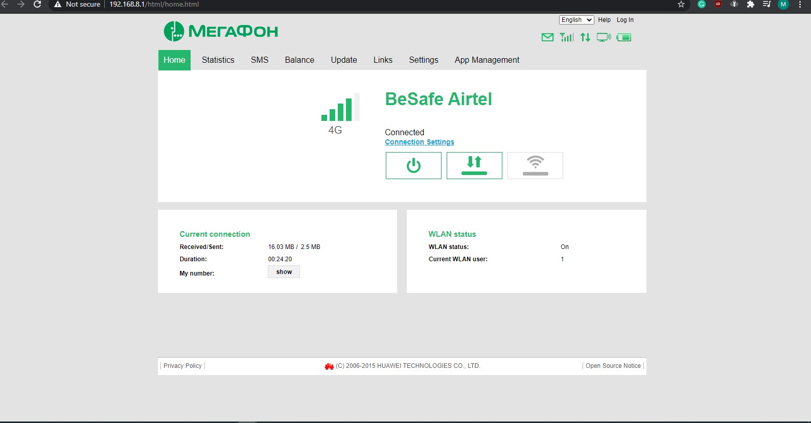

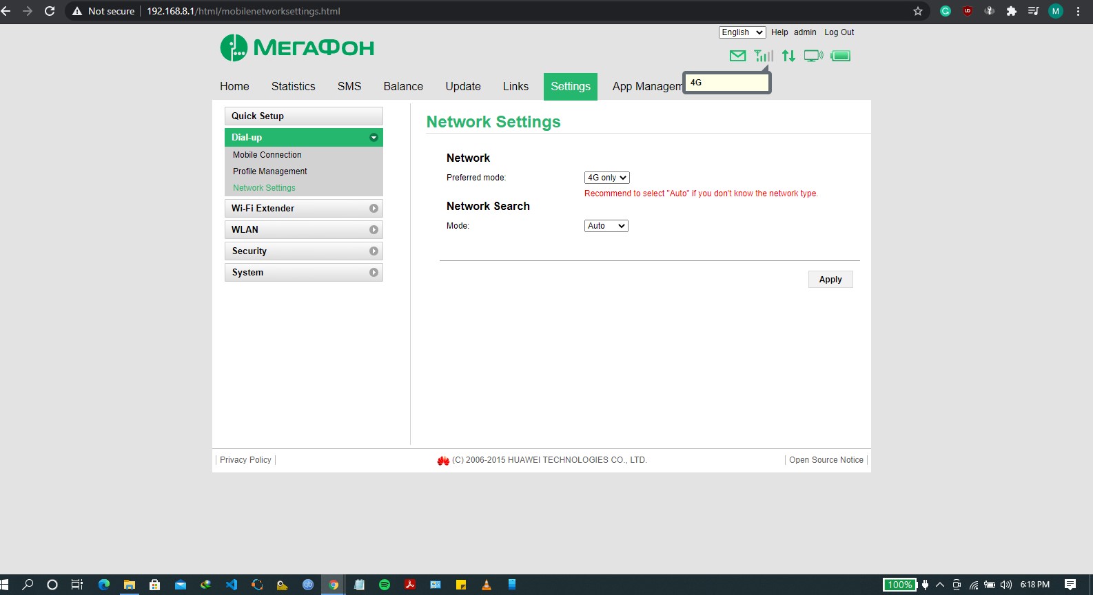

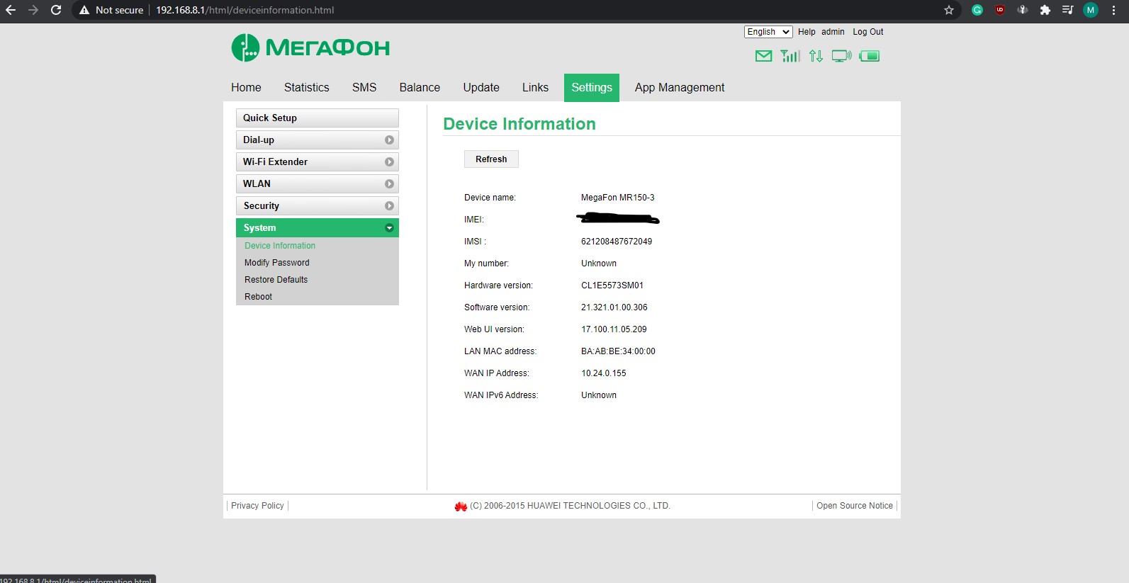

I just switched it back on to get a screenshot and for some reason, I had network on 4G. The first time since I flashed the firmware v21.321.01.00.306 weeks ago. I don't know if it is temporary.
The Original firmware version: 21.316.03.00.200
Web UI screenshot attached
