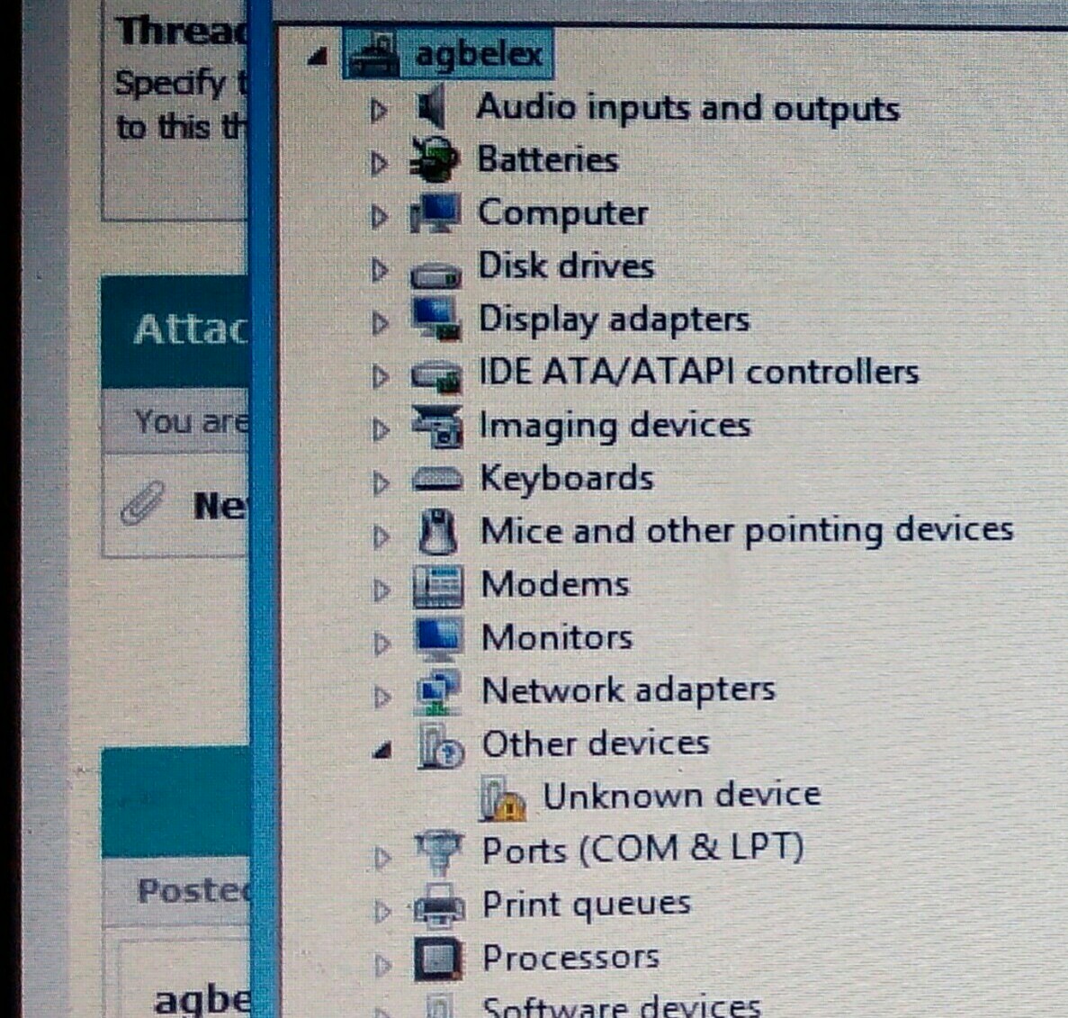

Hi Hovatek! Pls i need ur help on how to install driver from another mtk phone.
I hav connected d phone (turned off) to my pc through usb cord. D driver has bin installed bt wen i connect d bricked fone to pc for sp tools use, d progress bar in sp tools remin stagnant (0%). Please help

Thank you, sir. The driver worked bt white d flashing wat taking please, The usb cable show so in hav an error message.
I clicked "cancel" and restarted the flashing progress (download " using dsame sp flashing tools but the pc gives a notification doing" usb driver not recognised". The fone wait display anything it just remains dead.

I just did use another pc and usb cord bt it still shows "usb not recognised " and nothing else. The fone jux remain blank. When i try 2 turn it on, it doesn't come on and it gives no sound. It remains blank even wen connected to the original charger for hours.
The only respose i get is wen i connect it to pc, d pc shows "usb not recognised". Am so scared!

My phone is infinix hot note x551.
Yes! D flashing was interrupted by disconnection of the usb cord while flashing.
Iv been chargin 4more dan 5hrs nw bt still hasnt got any +ve response.
Iv also tried 2use another pc and usb cord bt still "usb device not recognised" is wat pops up in d pc
What do i do next, pls!
