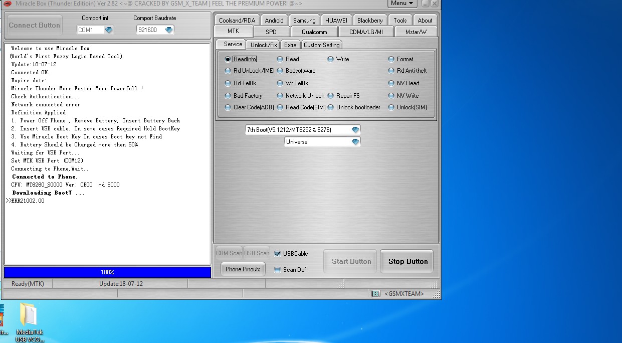

pls help any solution for miracle error ER21002.00 ANY TIME I TRIED TO READ OR READ INFO I GET THAT ERROR ANY SOLUTION

(15-09-2021, 02:41 AM)San5223 pls help any solution for miracle error ER21002.00 ANY TIME I TRIED TO READ OR READ INFO I GET THAT ERROR ANY SOLUTION
what's the device model, chipset and android version?
what boot did you select in miracle? attach a full screenshot of the tool & error message

i entered 4th auto connect and it automatically select the boot and wrote downloading boot an later wrote that error code i tried two phone the first is gionee s9 mtk android d 7 an the other is small button phone i would attach screenshot later but i think the problem is not with the phones i had just wanted to test miracle with the phone

this is the screenshot

(16-09-2021, 01:59 AM)San5223 this is the screenshot
in your screenshot, chipset of the device is mt6260 while in miracle, you have boot 7 that's not related to mt6260
open the dropdown and select the correct chipset for the device then try again
