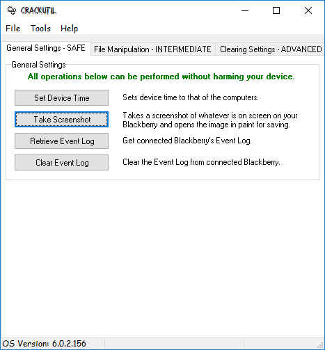

  4. Run Crackutil as admin (MUST)
    [Image: attachment.php?aid=1170]

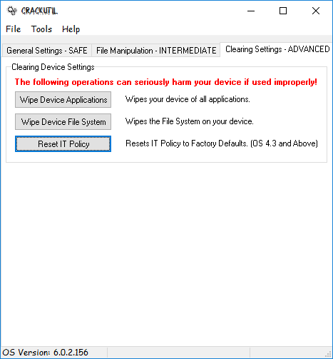

  5. Click on "CLEARING SETTINGS-ADVANCED"
    [Image: attachment.php?aid=1171]
  6. Click on "Reset IT Policy"
  7. Type "ResetITPolicy" in the small window
  8. Wait for the device to finish wiping
  9. Done
