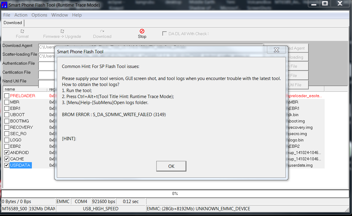

hi may you help me about thl w8 sp tool error.UNKNOWN_EMMC_DEVICE and S_DA_SDMMC_WRITE_FAILED(3149) by the way it came up when i took off battery out when it stopped responding. i tried many way but its same.. can anyone help me about this?

Everything is ok,drivers sptools stock roms , when i open cwm recovery mode by press vol + / power it said cant mount something(if yu want i will write) so i try to wipe data factory reset it said ok but nothing change. and i retry to sptools again S_DA_SDMMC_WRITE_FAILED but when i turn on phone it only says encryption unseccessful again

1. what we're you doing before your phone started Malfunctioning / it stops working i guess, screen closed and power on off switch not worked. then i unplugged battery out. then i plugged battery and it started as usual,when logo gone it said Uncryption Unsuccessful and a reset button that is not working.
3. What exact error did you get in recovery mode and is it stock recovery mode CWM or TWRP? / iam using CWM and tried to wipe factory reset and dalvik also. it says done but nothing changed. when i try to use sptools it always end like i add attachment. here is result Sad
.png   ss.PNG (Size: 171.34 KB / Downloads: 6)
