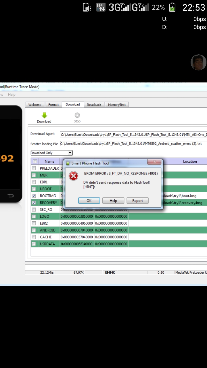

Panasonic P81, MT6592, Rooted, Have clean CWM backup
Changed building properties and bricked
Stuck at boot logo
Tried SP flash tool (5.1343.01) and got error 4001
BROM ERROR: S_FT_DA_NO_RESPONSE (4001)
DA didnt send response data to FlashTool!
[HINT]: (No hint!!)
.jpg   p81.jpg (Size: 273.13 KB / Downloads: 3)

you'll need to flash the system.img . can the phone enter recovery mode? and is it Clockworkmod or stock recovery?
hovatekIMG ateline='1417784263' Wrote: you'll need to flash the system.img . can the phone enter recovery mode?  and is it Clockworkmod or stock recovery?
ya.....and its stock recovery....flashing cwm ll work? i hv cwm back up from the source...
should flashing only boot.img work?
(12-06-2014, 08:25 AM)sagarpatel Wrote: ya.....and its stock recovery....flashing cwm ll work? i hv cwm back up from the source...
one way or the other, you need to flash system partition to the phone since that's where build.prop is. since you have a CWM backup, here's what you'll do
1. boot the phone into factory mode (volume down + power)
2. flash CWM recovery to the phone using. https://forum.hovatek.com/thread-455.html
let's know how it goes
